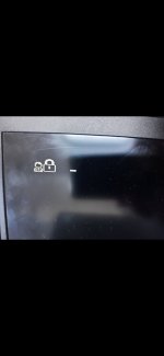

my problem is removing bios password about it unlock bios is required
